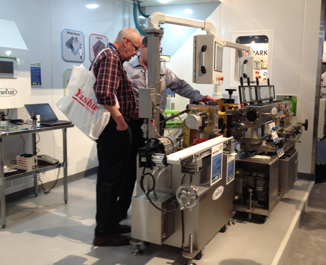

The installation at NPE combines features of ISO Class 7 and Class 8 cleanrooms, white rooms and hybrid environments. It includes simulated processing machines and an array of auxiliary equipment, HEPA filtration units and other support equipment
Elements on display include:
  • A climate-controlled white room, where products are made under standard HVAC conditions. A simulated molding machine is located outside of the room with HEPA filtration above the molding area. A MicroWheel dryer is mounted on the machine and molded products are conveyed into the cleanroom for further processing under controlled conditions.
  • A hybrid cleanroom with a simulated extruder outside the cleanroom area. Extruded product exiting the die enters the cleanroom through a small opening in the wall and passes into a cooling tank and puller/cutter unit inside the cleanroom. These MedLine units, which were introduced several years ago for medical extrusion applications, have now been updated for cleanroom operation.
  • ISO Class 7 and 8 cleanrooms with two simulated HEPA filtered blowers that deliver air, largely particulate-free, to the room. A simulated vertical-clamp injection-molding machine is serviced by a MedLine TW Premium temperature control unit and a new MedLine micro receiver mounted on the hopper of a MedLine MicroWheel dryer. A MedLine FLX material-handling control system, with a clean touch-screen display, controls delivery of dried resin from a three-hopper ResinWorks sled (located outside the cleanroom area).
