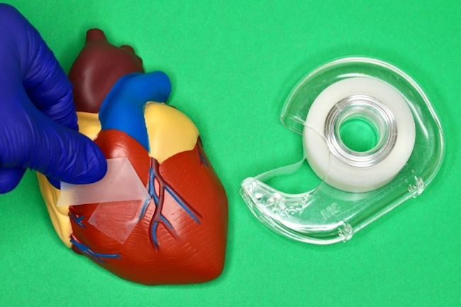

Surgeons can use the detachable adhesive for internal organs like Scotch tape, applying, detaching, and reapplying it on demand. Image courtesy MIT. |
