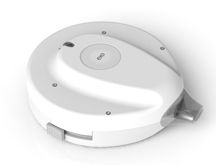

Syqe-Inhaler-Exo-300.jpgThe palm-sized Syqe Inhaler Exo, designed for clinical use, works with cartridges that are preloaded with cannabis granules. The device has already undergone a successful clinical trial in Israel. "The study was published in the Journal of Pain and Palliative Care Pharmacotherapy, supporting the claim [that this is] the world's first metered-dose cannabis inhaler," says Davidson. The device will be available for use in hospitals and healthcare settings in Israel in Q4 2014; a home-care version is planned for 2015.
Meeting ambitious time-to-market goals was largely made possible through the use of 3D printing, says Davidson.
Almost three-quarters of the Syqe Inhaler Exo's parts were 3D printed in house using multiple Stratasys printers, says Davidson. This strategy allowed the company to rapidly and successfully complete the human clinical trials.
Different materials were selected for the four main components of the device—the shell, chassis, airway, and thermal housing—to achieve "rigidity, clarity, biocompatibility, and heat resistance," says Davidson. "We used the family of Vero photopolymers, digital ABS, MED610, and PLA, and we printed the parts on Objet30 Pro, Connex3, Objet Eden260v, and Replicator 2 systems."
syqe-cannabis-300.jpgThe flexibility of 3D printing also made the technology invaluable for producing the needed tooling and testing systems during four years of R&D. "Since metered dose inhalation of raw botanicals is a highly unconventional undertaking, we had to develop the tooling and machines for many of our processes," explains Davidson. "More than half of our production equipment, jigs, and analytical tools were printed in house."
Although Davidson and his team expect to shift to other manufacturing technologies as they scale up for mass production, 3D printing has worked so well for them that they are seriously considering using it to print specific components.
