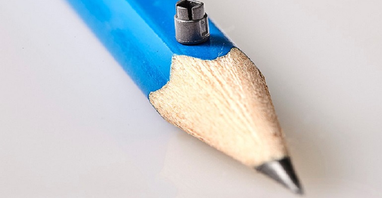

Whether it’s for medical or electronics, extremely small parts are in demand.  The miniaturization trend has been growing (so to speak) for decades. Micro molding technology has been following this trend on down. Some molded parts are smaller than the thickness of a human hair. By small, think amazingly tiny. “Our smallest molded form is over one thousand parts per plastic pellet.  That’s extreme,” Brent Hahn, Isometric’s director of global sales, told Design News. “We handle up to six-inch parts, but they still have micro-features that may be single microns in size.”
