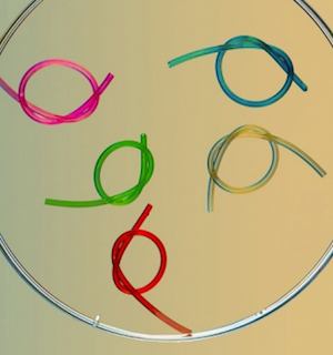

Even after MIT researchers tied the coated tubing into a knot, the hydrogel coating remained strongly bonded and
no tears were found in the material. Image courtesy Felice Frankel, MIT.
