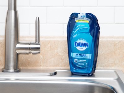

Procter & Gamble’s liquid packaging technology uses compressed gas to provide tailored rigidity to create structure in flexible films, uses 50% less plastic than a traditional rigid bottle, and has a 360° palette for design.

The liquid packaging technology uses compressed gas to provide tailored rigidity to create structure in flexible films. By utilizing a proprietary one-way valve, the new packaging form delivers cleaner dispensing, more controlled dosing and more convenient one-handed use while still being tough enough for e-commerce shipping without extra protection. Air Assist also uses 50% less plastic than a traditional rigid bottle and has a 360° palette for design, making it a more resource-efficient solution.
Air Assist liquid packaging technology uses compressed gas to provide tailored rigidity to create structure in flexible films.
