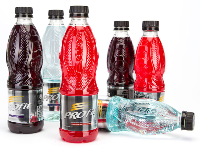

Amcor's Latin America design team, based in Miramar, FL, refreshed and revitalized Toni's hypotonic sports drink brand, transforming the previous standard cold-fill container into a stand-alone, iconic package that is "aggressive, sporty and modern," according to Carlos Londono, Senior/Group Lead Designer for Amcor Rigid Plastics.
Extensive research was done to improve the functionality of the packaging from ergonomic studies to container use constraints and goals. A thorough benchmarking study yielded insight that a container with improved gripability, solid contact points and aggressive styling that made a bold statement was needed to create a highly competitive and athletic container. The new container was designed with a nod to today's athletic equipment—the added texture mimics sports apparel and footwear.
"I designed this concept with the idea of sports protection equipment in mind [such as] American football pads, with their large block surfaces and textures," explained Jeff Klok, Amcor Rigid Plastics' Senior Industrial Designer, who spearheaded the design project.
Hence, the 350- and 500-ml polyethylene terephthalate (PET) bottles feature a sport-infused look with a highly reflective and clean label with ghosted attributes. These are tied together with hexagonal texturing on the label and container, according to Klok. One of the container's unique features is the lowered location of the labeling panel. This was done to make the bottle more stable in a bicycle water bottle holder. In addition, lower label placement was useful in differentiating the bottle and disrupting the visual competition that occurs on the retail shelf.
"Many competing packages are all similar either in design, language or even formula," Klok explained. "With PROfit we chose to relocate the label to break up the shelf presence. We also used exaggerated surfaces on the container as a means to increase the visual strength of the container in an effort to emphasize the design."
One of the most difficult aspects of the design was creating a texture that was both reproducible and conveyed the appropriate athleticism to elevate the brand, said Klok. "Patterning hundreds of little hexagons onto the package takes a lot of memory in a computer system, but eventually we developed ones that were detailed and uniform," he said. The hexagonal pattern offered a very strong and highly energetic appearance that was also reproducible in the blowmolding process.
