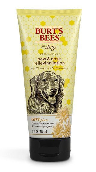

The award-winning laminated tube for Fetch…for Pets’ licensed Burt’s Bees for dogs Paw and Nose Relieving Lotion is Berry’s first commercialized tube using post-consumer resin (PCR) yielding a maximum of between 57% and 62% PCR, excluding the closure, depending on the tube diameter and length. The award-winning Burt’s Bees tube specifically contains 60% PCR, excluding the closure.

Berry: This is Berry’s first commercialized PCR tube yielding a maximum of 60% PCR, excluding the closure. This is achieved by using up to 53% PCR in the tube sleeve and up to 75% PCR in the tube shoulder.
We started out with a commercial product at 13% PCR in 2009, but over years of development we were able to increase the level resulting in the first tube to be released with this level of PCR.
We found this amount of PCR allows the tube to meet all the same quality, performance, and processing standards as non-PCR tubes.  We increased our maximum PCR percentage more than five times with this new material blend, and added PCR to the tube shoulder for the first time.
