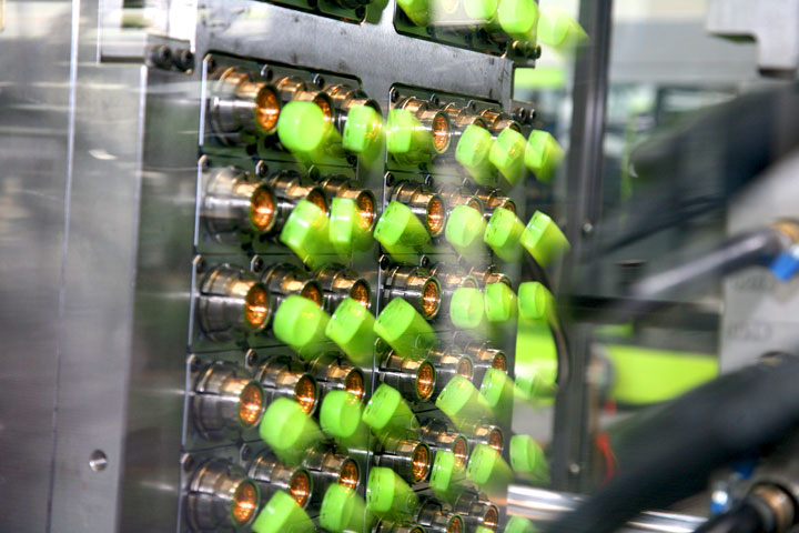

Engel e-cap machine is producing 130,000 caps per hour at NPE2012.
An all-electric ENGEL e-cap 3440/460 US injection molding machine at the show in Orlando, FLA uses a 96-cavity mold, with an hourly production rate of almost 130,000 high-density polyethylene water bottle caps. Cycle time is a crisp 2.7 seconds.
