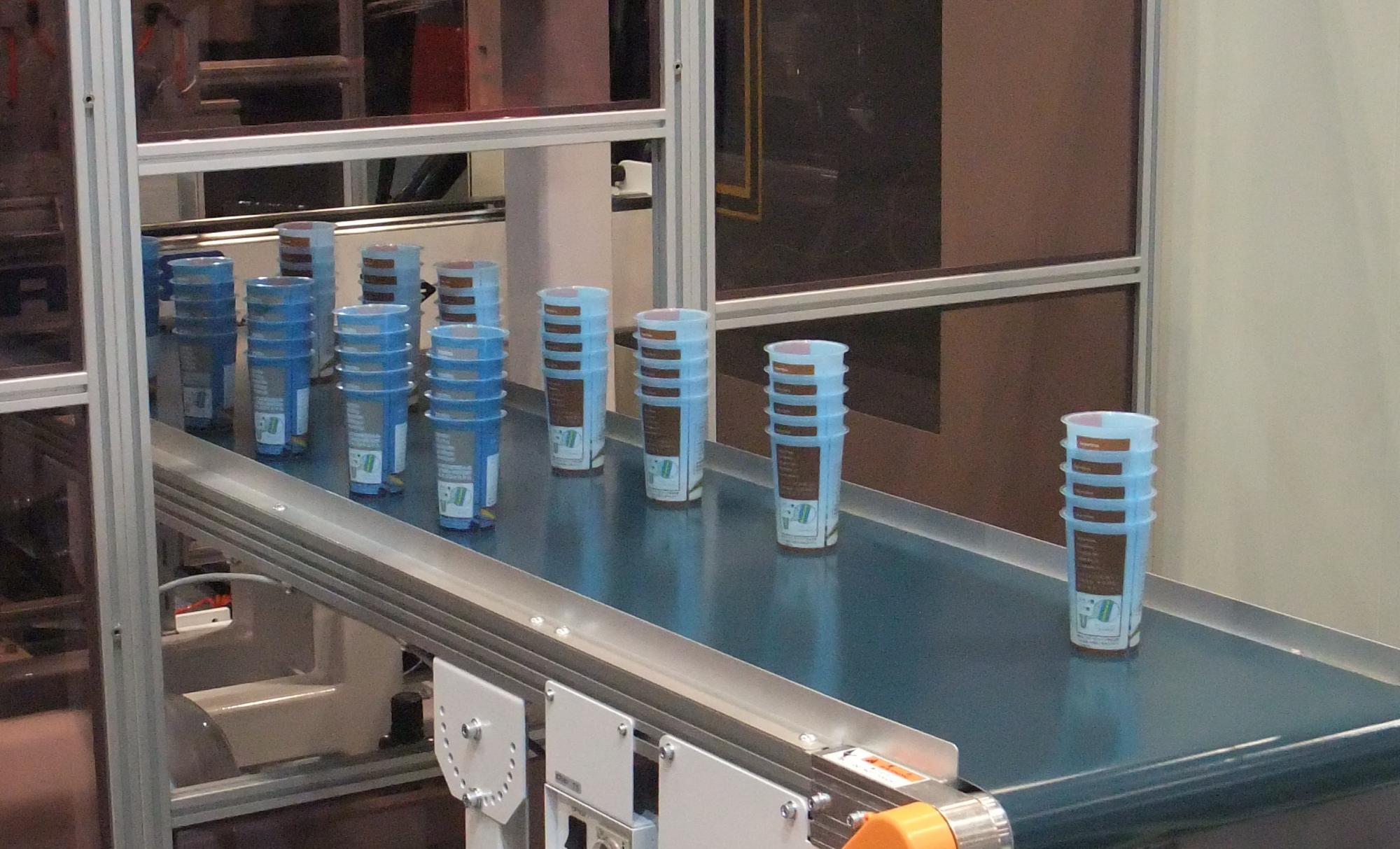

A high-speed beverage cup solution was displayed by Nissei at the recent IPF Show.

Nissei also applied an existing injection machine to a high-performance packaging application at IPF. The 2160-kN NEX220 III-50ETN all-electric machine was molding multi-layer beverage containers in a four-cavity mold in a cycle time of 8.4 seconds (64 g/shot). The application is reportedly already commercial.
The 0.7-mm thin-wall containers were molded from polypropylene (PP) with a polyethylene (PE) core layer, and also featured in-mold labeling. "We employed PE in this demonstration at IPF due to the high cost of the EVOH barrier resin that would actually be used in this application," says Kazuo Usui, company director and head of technology at Nissei. Usui adds that in an actual production environment, a cycle time in the 7-second range would be possible for the multi-layer construction versus 3-4 seconds for a single layer container.
