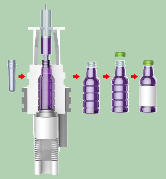

By using a consumable, pressurized liquid instead of compressed air to form plastic containers, LiquiForm technology combines the bottle forming and filling processes into one step. Ann O'Hara, President of LiquiForm, commented to PlasticsToday that the industry has been heading in this direction over time. "There is already the trend of connecting the blower and filler, which got us closer but that was still two steps, not just one."

"It will be a great value to the brand owners," said O'Hara. "The sustainability benefits will be huge. Blowing air into a bottle uses a lot of energy. With liquid being incompressible, it makes a more precise definition of the bottle while allowing for lightweighting, as well."
