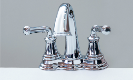

In response to the demand for high-performance polymers that are able to withstand the stringent requirements of hot-water contact, Netherlands-based Royal DSM is now taking its biobased EcoPaXX polyamide into the market for drinking water contact applications. According to the company, use of this material offers a high-performance, lead-free option for applications such as faucet mixing valves.
The water management market is not the only force that is acelerating the trend towards the use of performance polymer materials for hot-water contact: legislation also has been driving replacement of metals in applications that involve direct contact with drinking water. Brass and other metals traditionally have been used for such applications as faucets, water-meter and boiler components. Lead contamination in drinking water is a major concern worldwide, leading to more stringent regulation on lead limits in drinking water. This has led the industry to look for alternatives, and engineering plastics such as EcoPaXX offer a completely lead-free solution, and fully comply with those regulations.
Leading industry players already are successfully using EcoPaXX Q-DWX10, a 50% glass-fiber-reinforced polyamide 410, for faucet mixing valves because of its outstanding performance. This material enables the design of faucet mixing valves with lower risk of part failure and water leakage, a key focus for the industry.
Faucet mixing valves need to provide long-term durability and perform reliably when in contact with both warm (60oC) and hot water (90oC). EcoPaXX offers superior toughness, better hydrolysis resistance and dimensional stability than other polyamide-based materials. It not only is lead-free, but also yields improved torque and bending strength, even after extended exposure to boiling water. EcoPaXX absorbs 30% less water and offers superior chemical resistance, which is especially important when in contact with chlorinated water. It has passed more than 1 million lifetime cycles testing in varying water temperatures, and fully complies with all major drinking water certifications, such as NSF61 and KTW.
