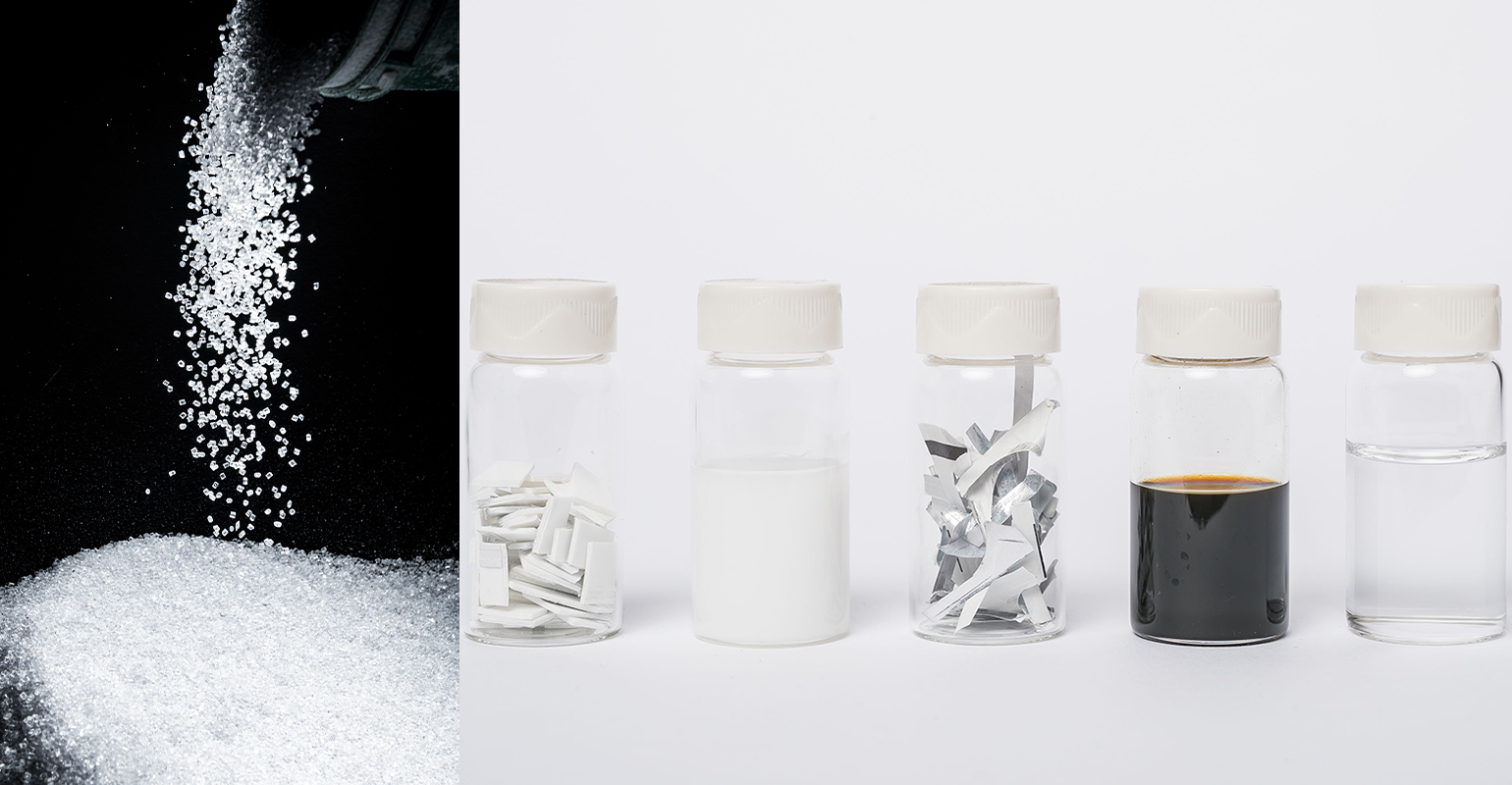

Following the Advanced Recycling Conference held in Cologne, Germany, Pyrowave announced November 17 it reached a major stage for the future of global plastic recycling in the fight against climate change. Pyrowave technology has successfully passed Michelin Group’s quality tests with the first 99.8% pure recycled styrene monomer produced from polystyrene (PS) waste. Recycled monomer can now be integrated into industrial elastomer batches. For the first time, a finished product will incorporate fully traceable and segregated recycled styrene, where all the styrene will be physically present in the product versus a mass-balance, credit-based content scheme.
The styrene monomers are made using Pyrowave’s microwave process. The monomers are identical to virgin material, yet with a 45% reduced carbon footprint. They can then be reused in the production of items made from recycled materials and share the same applications as virgin materials used in transportation, packaging, electronics, and construction. This approach provides a circular economy solution to the global plastics recycling challenge.
A load with approximately three tons of recycled styrene left Montreal, Canada, for the Michelin plant in France (seen below). Following years of testing, Michelin will be positioned to manufacture batches of industrial styrene-butadiene rubber (SBR) products with Pyrowave recycled styrene.
