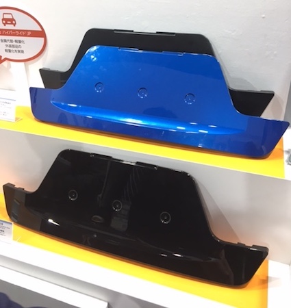

PC alloy grades such as PC/PET boast superior finisheswhen painted, be they foamed or non-foamed moldings. |

Kaneka introduced its prototype, patent-pending PC alloy at the recent Automotive World show incorporating the 7th Automotive Lightweight Technology Expo held January 18–20 in Tokyo. The supplier’s Hyperlite JP high flow PC/PET alloy was also showcased for adoption in components such as front hood covers, rear spoilers and garnishes, roof side covers, and slide door end garnishes. The first commercial application is in the rear roof garnish of the latest Toyota Prius model.
