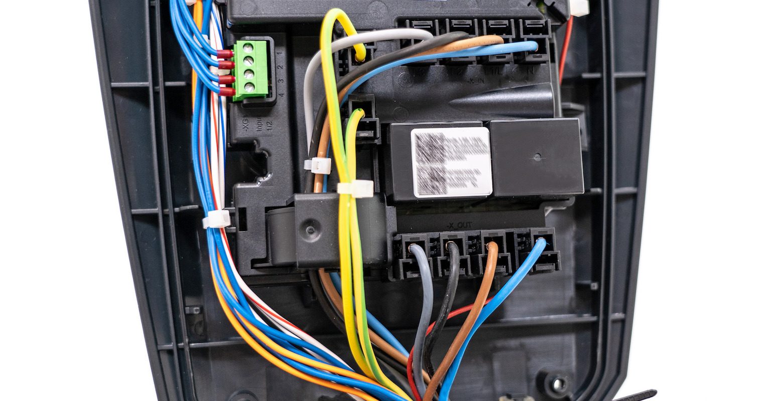

charging cable connectors made of Durethan BKV20FN01
Image courtesy of Lanxess

The charging-cable connectors made of halogen-free, flame-retardant Durethan BKV20FN01 polyamide 6 are used in Kostal Enector wallboxes.
