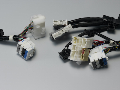

The Polyplastics Group is offering an improved polybutylene terephthalate (PBT) grade which provides improved tracking resistance for a range of high-voltage automotive components. Duranex PBT CG7030 is a 30% glass-filled grade which also delivers strong dimensional stability and highly stable electrical resistance and dielectric breakdown properties.
PBT connectors absorb less moisture than those molded from PA 66. Image courtesy of Polyplastics.
