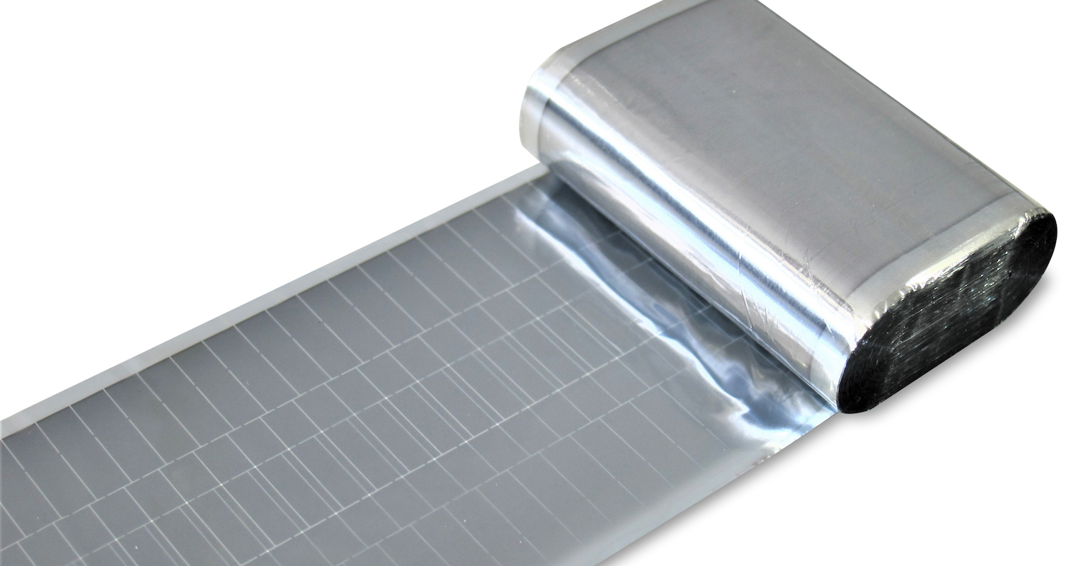

Compared with other high-heat materials, such as polyethylene terephthalate (PET) and polyethylene naphthalate (PEN), Sabic’s Elcres polycarbonate copolymer–based HTV150A films reportedly can reduce dissipation losses by as much as 40% when exposed to temperatures reaching 150°C and frequencies up to 100 kHz. The material has already proven its mettle in thin-wall capacitor films.
Lower dissipation losses in Elcres HTV150A dielectric films can reduce internal heat generation, increase operating efficiency, and stabilize hot spot temperatures, giving engineers greater flexibility in designing capacitors. Lower losses in these films are expected to translate into reduced dissipation losses in capacitors.

Elcres HTV150A dielectric films are the first in the industry to provide stable performance at operating temperatures between -40° and 150°C and frequencies up to 100 kHz, while offering stable capacitance, high insulation resistance, and good dielectric performance. They address the critical performance gap experienced by traditional polypropylene (PP) films above 105°C.
Capacitors built with 3- and 5-µm metalized Elcres HTV150A films pass standard electrical and life tests at 150°C for 2,000 hours with low capacitance change and stable insulation resistance. Other key properties cited by Sabic include high breakdown strength over the full temperature range, good self-healing, and excellent adhesion to aluminum and zinc during metallization. The film has been validated by customers for use with both film-foil and metalized electrodes.
