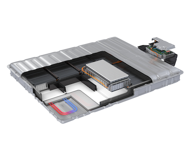

Battery modules with cylindrical cells are constructed with Covestro’s Bayblend© material and efficiently assembled with Henkel’s Loctite adhesive. Image courtesy of Henkel.
