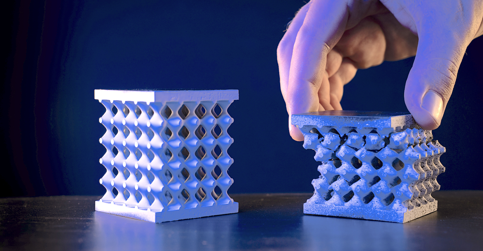

The result they’ve discovered is a modular repeating structure of tiny pyramid shapes. It is 3D printed from liquid resins and produces a structure that holds 30,000 times its own weight. Durability testing has shown that the material can create battery frames that exceed steel in energy absorption while providing a substantial mass reduction.
However, 3D printing is not a viable solution for the production of such parts, notes Hendrik Mainka, who is head of the Knoxville hub. “We are using 3D printing here for prototypes, but we will not use additive manufacturing for volume manufacturing, he explained.
It is necessary to use 3D printing for these prototypes because the shapes created by AI can only be made that way, Mainka said. “It is really impressive, the capability of this method,” he said. “Getting closer to the material properties we are expecting.”
