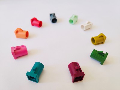

FAKRA connectors provide 6 GHz of bandwidth to handle 5G cellular/data traffic and enable the next generation of automotive monitoring, diagnostic, safety, performance, navigation, and entertainment systems. Image courtesy of Clariant.

Named for the German auto-industry group that developed the standard, FAKRA connectors provide 6 GHz of bandwidth to handle 5G cellular/data traffic and enable the next generation of automotive monitoring, diagnostic, safety, performance, navigation, and entertainment systems. FAKRA details 14 dimensionally standard plug/jack combinations, each assigned with a color, a function, and a coded mating configuration that prevents mis-connections. Connectors are made with high-temperature-resins (HTRs) because their coaxial circuits are often bonded to printed circuit boards (PCBs) using lead-free reflow soldering at peak temperatures of 260°C (500°F).
