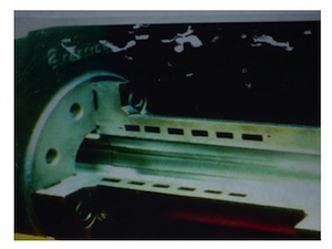

Grooved barrels. This concept was developed in Germany in the 1970s to get a lower melt temperature—hence, faster output—for HDPE blown film. The grooves (see photo with ¼ barrel cut away) direct the flow downstream, allowing a much lower rpm for the same production rate; a lower speed reduces overheating downstream in the mixing/metering zone of the screw. To do this, the first (feed) zone must be cooled enough to prevent melt from sticking in the grooves; it is typically a separate barrel section flanged to the main barrel. Unique screws have been developed for this process, including mixing assists in the last zone and/or afterward, as channels in that zone are deeper and mixing is consequently less intense. The concept works remarkably well for low-friction HDPE pellets. It does help with other resins, but to a lesser degree, and, therefore, is seldom used.
