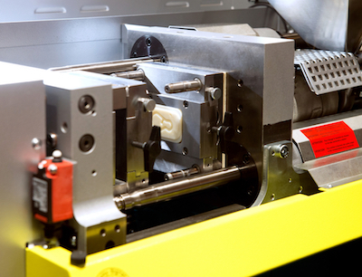

When filling the mold, you should keep in mind you are putting a molten liquid into a metal mold that is well below its melt point. The second the plastic touches the mold it solidifies. Fortunately, it cools from the outside in, so there is a period of time that the melt can travel down its center to completely fill the mold. As a general rule, plastic cools at the same rate. For this reason, you should always fill from a thick section into a thin section. If you did the reverse, the thin section would freeze off before you filled and packed the thick section.
Plastic molecules are very long, many of them with branches. Because of this, one end of the molecule can be in a liquid phase while the other isn't. This “stretches” out the molecule and gives us the property of “apparent” viscosity. What this means is that when the plastic is moving quickly through the mold it is a relatively thin liquid. However, plastic molecules prefer to be tangled together. Once the movement slows or stops, the molecules that are still in some form of a liquid state contract back into their preferred tangled geometry. Pressure follows the path of least resistance. Adjust the gate sizes until every cavity gives an identical part weight within 5% of the overall part-weight average. If a cavity's part is too heavy, it's filling first and over-packing—this will be the problem cavity that will stick all the time. If it's too light, you'll over-pack the other cavities to fill this one out, otherwise it will be full of flow lines, sinks and voids.
Because of this phenomenon, it is in your best interest to fill the mold as quickly as possible with liquid plastic and then hold it under pressure to offset the thermal shrink, because it allows the plastic to reform back into its preferred molecular orientation.
Injection molding is a heat-transfer process. We heat the plastic to a molten phase, inject it into the mold and cool it into a preferred shape. You need even heat transfer. Think of the humble box. We tend to put the ejector pins in the corners for ease of ejection. We tend not to put cooling in the corners. Thus, the heat builds up in the corners and edges of the box and the wall warps inward.
Rule: Warp always goes toward the hot side.
For this reason, we try to cheat. We cool the cavity at the recommended temperatures but we lower the core's temperature in an attempt to cheat, using temperature to offset the poor positioning of the core's cooling lines.
Because this is a heat-in, heat-out process, the melt should be at the middle of the recommended temperature range. If the temperature is at the lower end, it will indeed shorten the time it takes to cool, but it will also solidify faster, resulting in short shots. The upper end of the melt point range will allow easier filling but the excess heat will lengthen the cycle time to cool off.
Filling should be done as fast as practically possible. Unless you've put a vacuum pump on the mold (see part three of this series), you have to have the plastic push the air out of the mold through the vents completely. This means the vents have not been squashed with excess or uneven clamp pressure and are clean enough to let the air easily out. More vents are better than fewer vents. As stated in a previous article—vent at the last point of fill, vent the ejector pins and vent the lifters and the parting lines. When the mold is full, the machine continues its injection pressure and compresses the plastic. At some point in time, it can no longer compress and the liquid turns hydraulic. This is where the plastic attempts to open or “blow” the mold. This is why you have a cushion on your load setting. Once the melt approaches becoming hydraulic, the machine should switch over into packing mode until the gate has frozen over and sealed the liquid inside.
