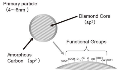

Dinnovare’s Structure |
Hindered phenols are commonly used to stop chain reactions caused by free radicals and hydroperoxide intermediates. Since Dinnovare has hundreds of functional groups that are similar to hindered phenols on the surface, they can scavenge peroxy radical intermediates through the oxidation process.
