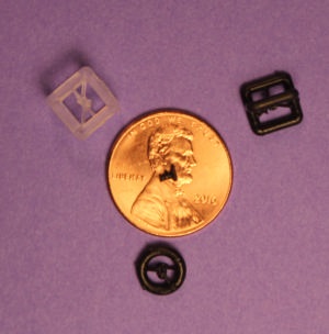

The photo shows the size comparison between a 3D printed prosthesis implant and a penny. Researchers developed the implants using CT scans and 3D printing for use in surgery—until now largely unsuccessful--that can help restore hearing loss for middle-ear-damaged patients. (Source: University of Maryland School of Medicine)
