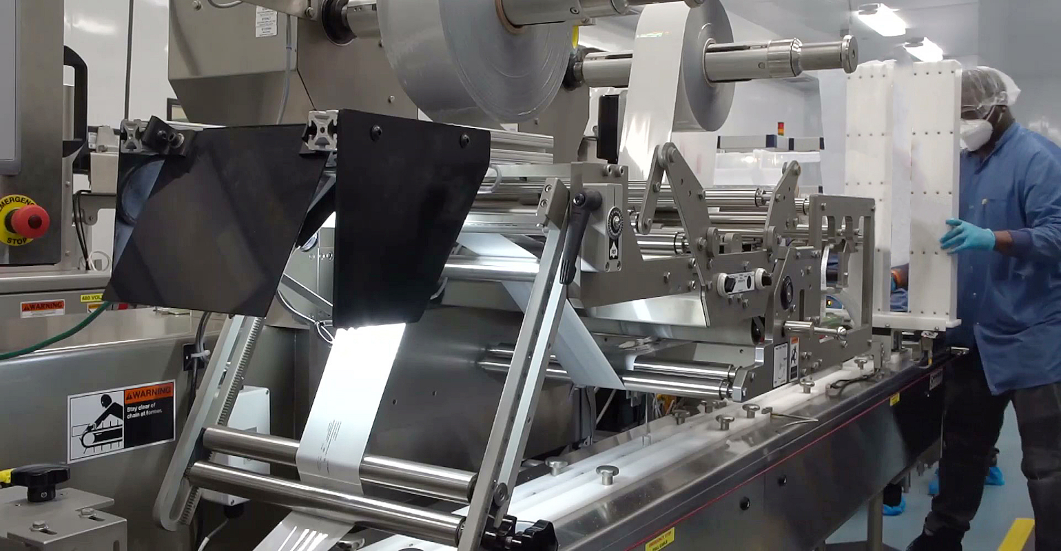

An operator at Web Industries in Massachusetts loads cassette magazines of test devices onto a Campbell Revolution Flow Wrapper. Using a form-fill-seal approach, the equipment packs each test kit, together with a desiccant pack, in a metallized pouch.Photo supplied by Web Industries

Young: Web is using a foil material to pouch an assembled test device. Rolls of metallized foil are received and run through the Campbell flow wrapper. Basically, this is a form-fill-seal process in which the foil is printed with the specific lot, date, and other information; formed into a pouch that the test device is inserted into, along with a desiccant pack; and then sealed.
Is Web also manufacturing the test device?
Young: Web does manufacture the device. We receive the chemistry from the OEM and laminate it onto a proprietary backing sheet. We create master rolls and then, using proprietary equipment, cut and place precise lateral flow assay strips into a bottom cassette. A top cassette is applied to fully encapsulate the lateral flow assay strip. These test devices are then run through the flow wrapper to be pouched, as described above.
