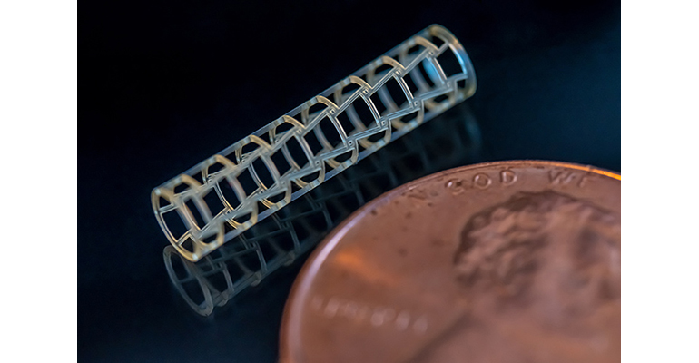

3D-printing equipment maker Boston Micro Fabrication (BMF) and UK-based 3D-printing materials company 4D Biomaterials announce that they have achieved the capability of printing micro-scale geometries using 4Degra bioresorbable materials. Reportedly the first time a bioresorbable material has been printed using this process, the technology has the potential to revolutionize the way implantable medical devices are manufactured. Miniature rigid orthopedic devices and micro-scale soft-tissue applications are cited by the companies as early opportunities.
The partnership combines BMF's projection micro-stereolithography (PµSL) approach with 4D Biomaterials' 4Degra resin inks. The inks are based on polycarbonate urethane chemistry and can be printed via PμSL and digital light processing to create finely detailed implantable medical devices that support the body's natural healing processes before degrading into harmless by-products that are absorbed and removed through normal metabolic processes. The chemistry can be tuned so that the 3D-printed product exhibits a range of mechanical properties.
