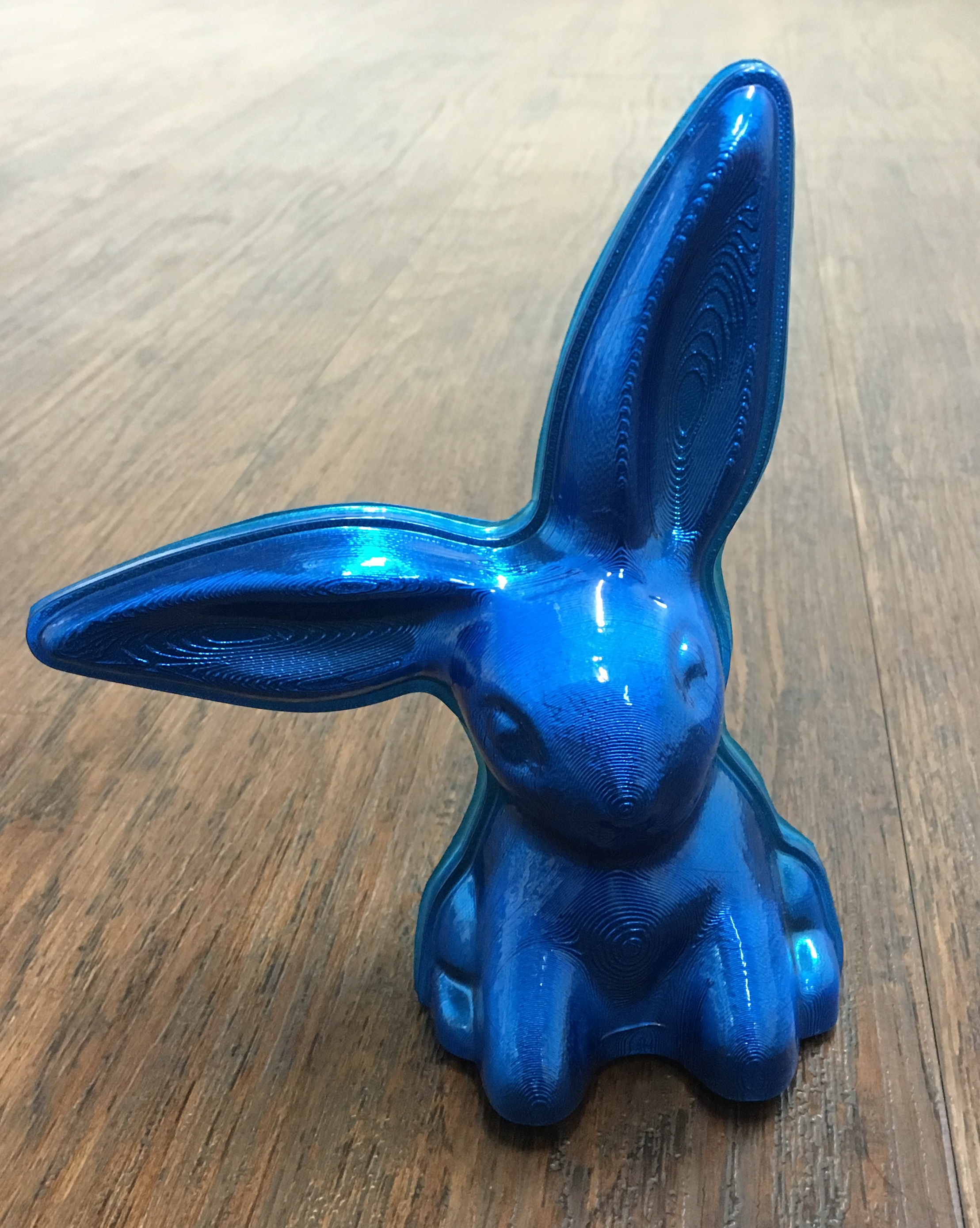

These aren’t your standard holiday bunnies, but 3-D bunnies with oversized ears that sit poised and wrapped in form-fitting blue plastic packaging.

The final packaging for the bunnies are thermoforms from plastic sheet. It's such a perfect fit that the packaging looks as if it were second, blue skin.
