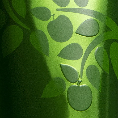

Patented technology from Berry Global, Inc. (Evansville, IN) precisely aligns intricate artwork with embossing or debossing on laminate tube packaging.
Berry Global, Inc. (Evansville, IN) has been granted a patent related to registered embossing on laminate tubes that extends the vendor’s premium, customized decorating techniques for Personal Care products.
The company’s unique process precisely aligns intricate artwork—words, logos or images with embossing or debossing to enhance the look and tactile experience of laminate tube packaging.
Such tubes are a poly-foil-poly structure that has polyethylene on either side of a thin gauge of foil and some laminate structures also incorporate paper, according to the Tube Council.
The new process allows eye-catching 360-degree decoration for 1 ½-, 1 3/8-, 1 3/16- and 2-inch diameter laminate tubes, creating a premium package which stands out on-shelf and enhances a customer's brand. PlasticsToday learned the maximum tube length is eight inches and that additional sizes are in development.
"Personal care packaging is all about premiumization now and this offers brands a new and exciting way to communicate luxury" says Rebecca Vara, Vice-President of Sales - Personal Care, who informs PlasticsToday that samples are readily available and the technology is production-ready.
“The process is done in-line with the standard printing process, it does not add any steps to the process,” Vara explains.
