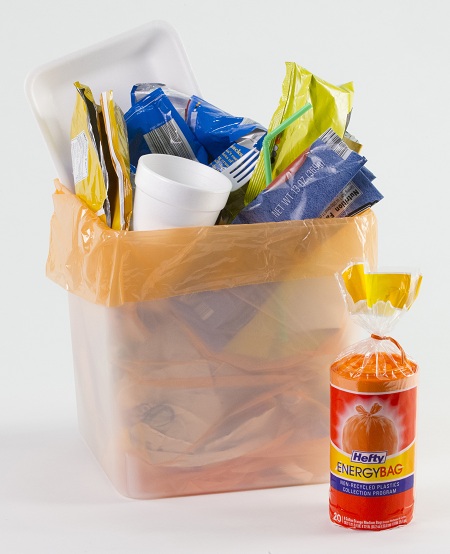

The plastics community continues moving forward to recovering currently non-recyclable packaging and other items and extracting energy from those materials. One of the most recent steps taken stateside was when Dow Packaging & Specialty Plastics (Midland, MI) and Keep America Beautiful announced in early January that two $50,000 grants were designated  for organizations in Cobb County, GA and Boise, ID, to establish the Hefty EnergyBag program in their respective communities.
The program offers an innovative approach to diverting plastics that cannot be recycled—such as chip bags and juice pouches—from landfills and converting the materials into valuable energy resources. The two winning communities will provide collected materials to facilities utilizing advanced non-combustion conversion technologies, which can generate a liquid fuel, such as diesel. To date, Hefty EnergyBag curbside and non-curbside programs, which include a 2014 EnergyBag Pilot in Citrus Heights, CA and permanent program in Omaha, NE, have kept 17.3 tons of plastics out of landfills.
