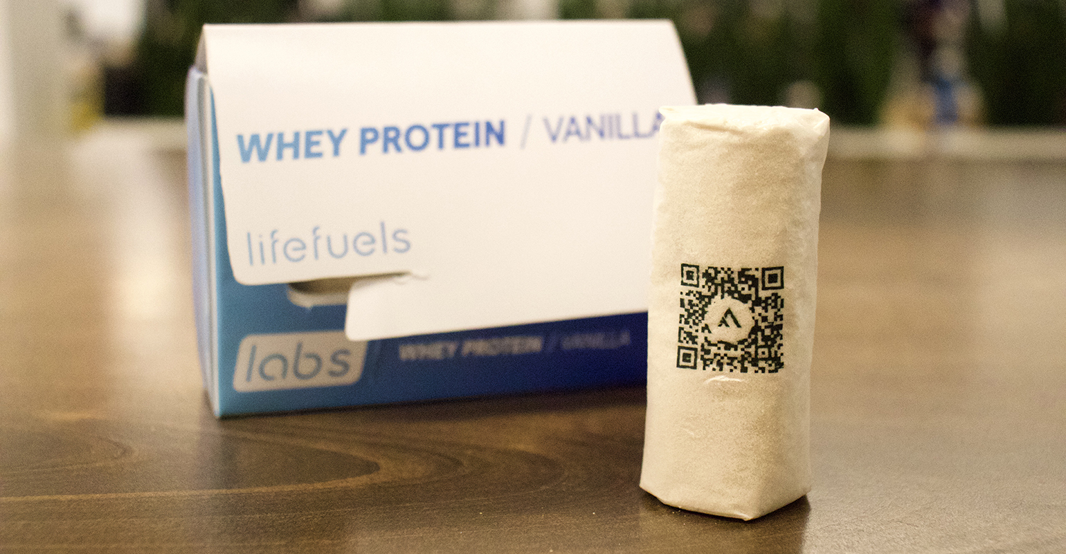

The company will shortly bring an even more sustainable packaging innovation to the platform: Cylindrical-shaped Modules, or Mods, which are powdered ingredients packs made of food-grade film that fully dissolve in water.
A Quick Response (QR) code printed with edible ink on the Mod film connects with the smart nutrition tracking platform via the LifeFuels smartphone app.
The innovative packaging eliminates the need for the usual plastic tubs, scoopers, or single-serving packets typical of the powdered beverage market.

“Our classic Pod package provides exceptional protection, dispense precision, and traceability for liquid concentrates,” says Mark Lyons, VP of engineering. “However, protein supplements are typically found in powder form and demand larger serving sizes. We wanted to find a way to deliver these nutritional products in a convenient form factor while maintaining the same level of consumption tracking within our digital platform.”

“The Module will be added to 450-mL of cool water in a bottle with 500-mL capacity,” explains Beverage Scientist Christine Shearer. “The lid is closed and the bottle shaken 5-10 times to disperse and dissolve the film and the powder. We have found that most consumers shake their protein powder bottles much more vigorously and longer than is actually needed for this process to take place.”

“We researched ingredients and methods for the preparation of different films and experimented in-house and developed a formula that had the flexibility, strength, heat sealability, and dissolvability we were looking for,” says Shearer. “The ingredients were either already in our ingredient pantry, available from our current suppliers, or in a few cases, required some research to find new suppliers. While researching printing on edible film we found that the cake decorating business offers considerable use of edible ink.”
A short video below shows the process for the QR-code-printed film.
