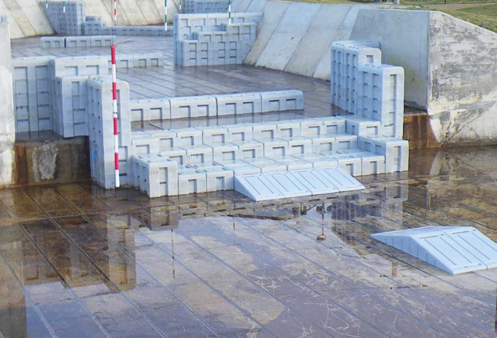

Boats aren't the only plastics featuring in water sports. The London Olympics whitewater kayaking course was constructed using Lyons, CO-based S2O Design's proprietary RapidBloc plastic blocks instead of concrete and permanently embedded obstacles. The blocks can channel water to precise specifications, and, because of the lightweight plastic-block construction, the course can easily be reconfigured for more recreational use. Glewood Springs, CO-based Whitewater Parks International (WPI) developed the planning-approved Compliant Design and course-related performance specifications for the newly launched Lee Valley White Water Centre in Waltham Cross, Hertfordshire, UK.
