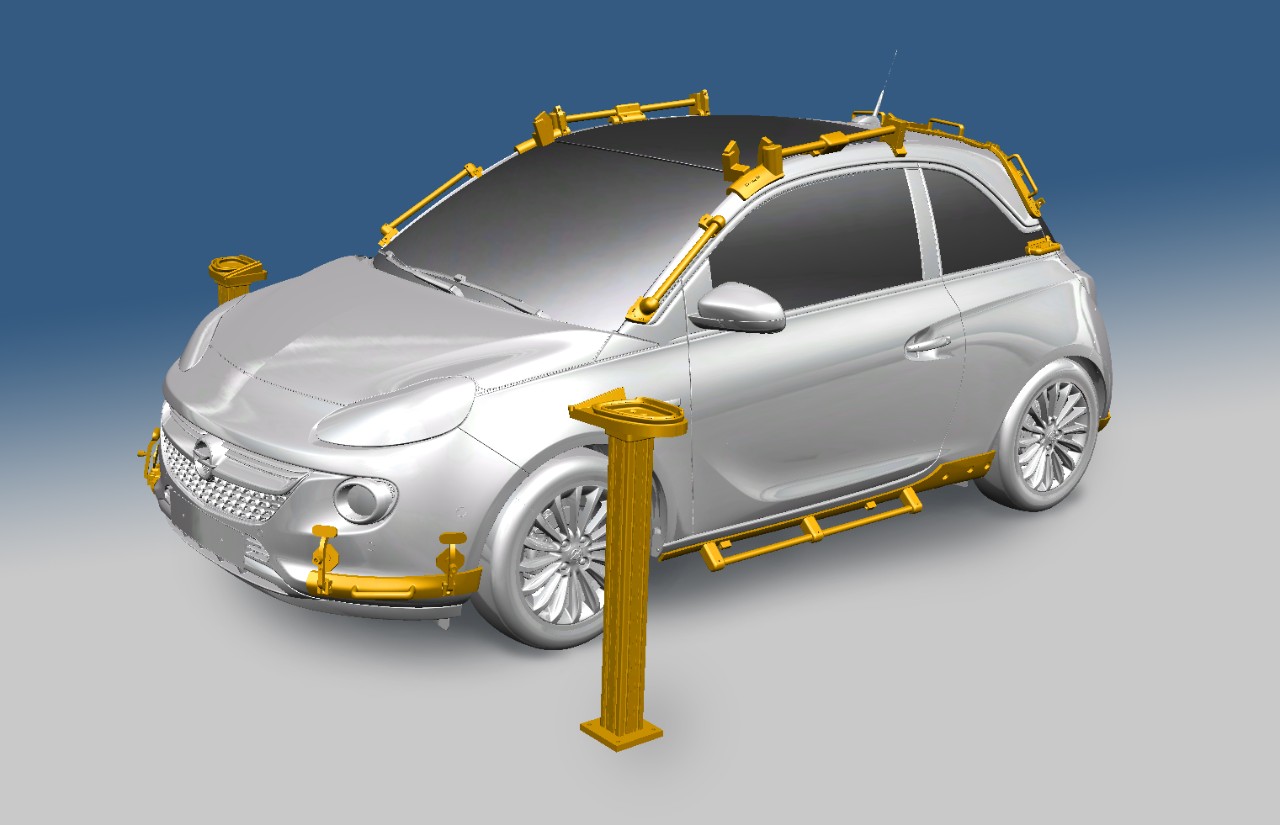

3D-printed assembly jig employed to produce Opel vehicle name logotype on side window.
For production of the Adam Rocks, to be launched in September, the Eisenach carmakers use an assembly jig - a specific, fixed frame - made by a 3D printer to produce the vehicle name logotype on the side window. And for the windshield, a 3D-printed inlet guide is also used to simplify the mounting process and help ensure a precise alignment. Other tools from the printer are used to fasten the chrome step plate on Adam Rocks door openings and install the standard Swing Top canvas roof. Around 40 such assembly aids and jigs are used in Eisenach.
This equipment was developed on the computer during the development phase of Adam Rocks. "It enables us to quickly adapt. If something changes on the vehicle, we can easily modify the tool with just a few clicks," explains Holl. "The 3D printing process enables us to produce every imaginable form and shape. Unlike conventional manufacturing technology, we don't have to accept any limitations."
Using technology to join a number of smaller elements, it is possible to produce larger tools and jigs beyond the size limitations of the 3D printers employed according to Opel. One such case was development of assembly aids for the side sill and the rear spoiler of the Adam Rocks.
