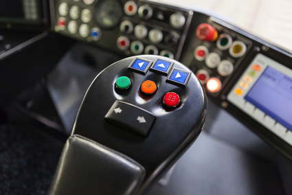

The Mobility Division of Siemens is pioneering the use of Stratasys FDM (fused deposition modeling) 3D printing technology by producing customized final production parts for German transport services provider, Stadtwerke Ulm/Neu Ulm (SWU) Verkehr GmbH. In order to meet the German rail industry’s criteria for production parts, Siemens is using a flame, smoke and toxicity (FST) compliant thermoplastic resin 3D printing material from Stratasys to align with necessary fire protection requirements. This enables Siemens to employ the 3D printed parts – which serve as lightweight and durable transport parts – directly into the trams.
Driver’s armrest is 3D-printed from FST-compliant thermoplastic resin. |
Using a Stratasys Fortus 900mc Production 3D Printer, Siemens Mobility is able to overcome the barriers of traditional low-volume production by 3D printing final tram parts in a matter of days compared to weeks with traditional methods, while also eradicating the need for costly tooling.

This cost-effective low volume manufacturing is being exemplified by Siemens’ work for SWU Verkehr GmbH, which offers transport services across 10 rail networks in the city of Ulm. 3D printed parts include customized armrests for the driver seat and housing covers for the ‘coupler’ (the cover of the link between two tram carriages).
