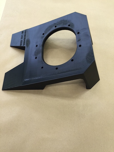

3D printed camera case prototype for the Airbus A380, produced on Stratasys' Fortus 450mc Production 3D Printer in ULTEM 9085 material (Photo: Business Wire)
3D printed tool used to install wiring in Airbus A380 camera case, produced using Stratasys' Fortus 450mc Production 3D Printer (Photo: Business Wire)

Traditionally, the company uses CNC machining for prototyping, but this has presented limitations. “We recently produced a 3D printed prototype to verify the fit and function of a part for the interior lining of an aircraft door,” explains Rieu. “Previously, this would have been made from sheet metal – an often-time-consuming process. With our Fortus 450mc 3D Printer, we produced a fully-functional prototype in two days, reducing our lead times by a staggering 95%. Crucially this has accelerated our design validation process before committing to costly and time-consuming tooling.”
Latécoère recently 3D printed a prototype camera case for the Airbus A380 aircraft for design validation with the camera’s internal parts housed inside. Prior to Stratasys FDM 3D additive manufacturing, the team would have been forced to directly manufacture an aluminum camera case for testing, with any design iterations proving costly. Using Ultem 9085 material, the 3D printed prototype is also 50% lighter than its metal counterpart, enabling more efficient functional part testing.
The company is also utilizing its 3D printer for the on-demand manufacture of customized production tools. This has not only seen significant reductions in time and cost, but also enhanced operator efficiency.
“Using metal sheet manufacturing, creating a tool can take up to six weeks. Now we can 3D print a tool in just two days and 50% lighter using Ultem 9085 material,” says Rieu. “With our 3D printer, we can also optimize the geometry of the tool to perfectly fit the part – making the operator’s job much easier. Not only has this accelerated our production process dramatically, but I also estimate that we’ve reduced our tool production costs by a massive 40%.”
