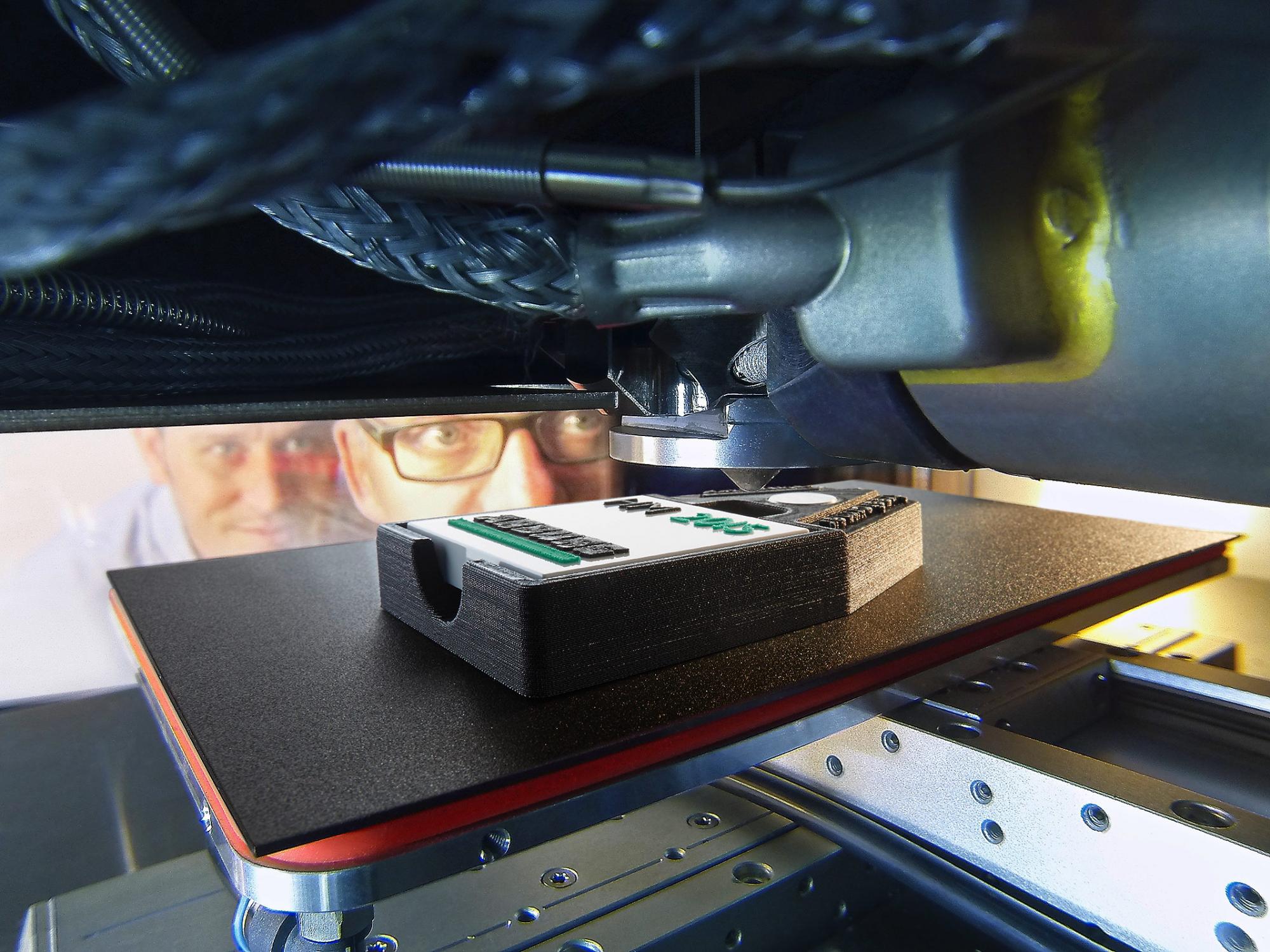

The Freeformer at the Thai show was producing gear cards |

At T-Plas 2015, the Freeformer was producing a spray head for cosmetics containers and a "gear card" from the acrylonitrile-butadiene-styrene (ABS) resin. Once the supporting structures have been removed in the water bath, the parts can be used as design prototypes as well as for functional and assembly tests. Currently the Freeformer can form parts using thermoplastic polyurethane (TPU), polycarbonate (PC), and polyamide (PA) 12, in addition to ABS.
