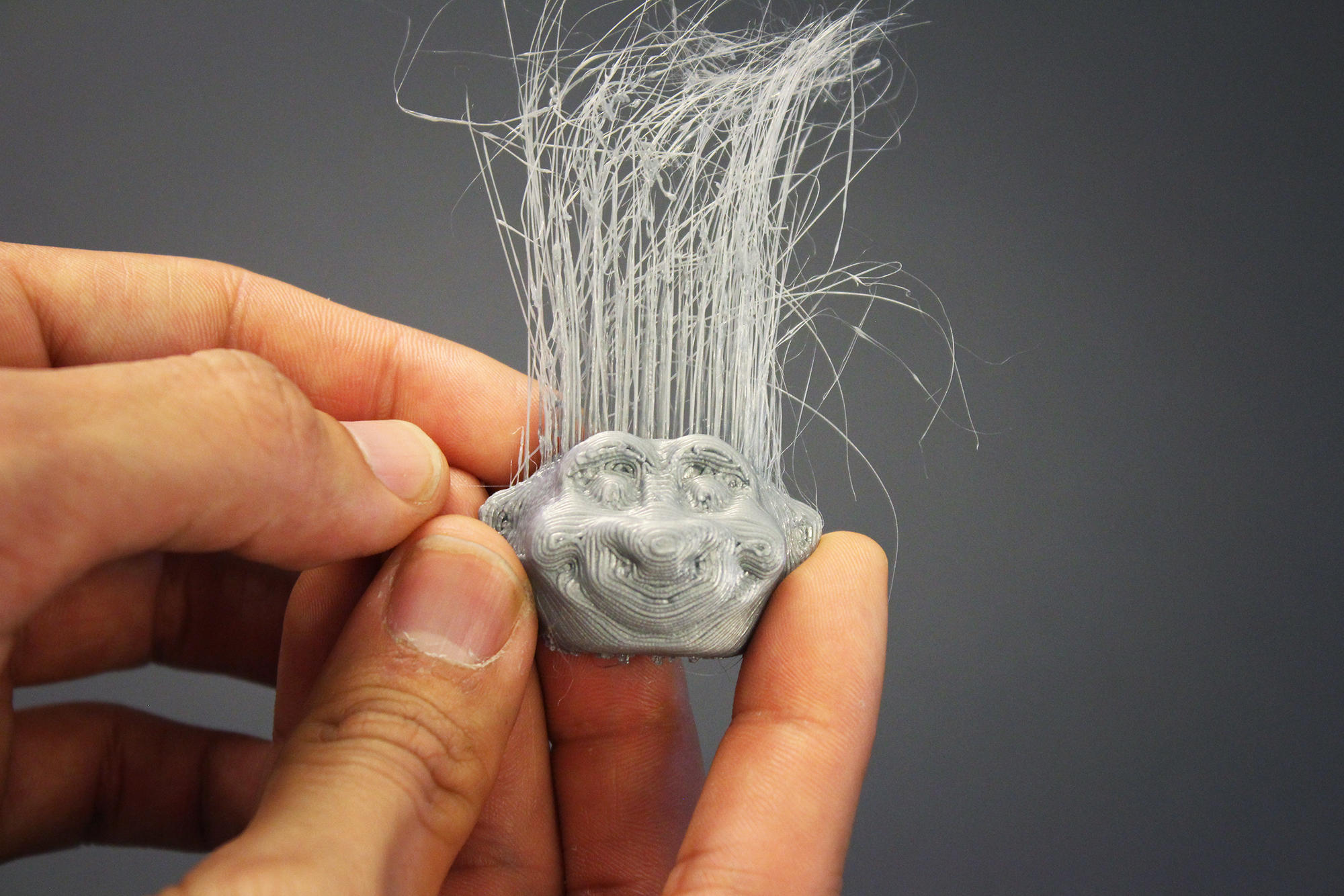

The idea for 3D-printing hair drew inspiration from the tiny strands you get when you pull a hot-glue gun away from a gob of melted plastic. The same concept can be applied to the plastic used by a 3D printer. “You just squirt a little bit of material and pull away,” said Gierad Laput, a Ph.D. student in Carnegie Mellon’s Human-Computer Interaction Institute. “It’s a very simple idea, really.”
The plastic hair is produced strand by strand, so the process isn't fast—it takes about 20-25 minutes to generate hair on 10 square millimeters. But it requires no special hardware, just a set of parameters that can be added to a 3D print job. The resulting hair can be cut, curled with hot air, or braided. Dense, close-cropped strands can form a brush.
Laput and his fellow colleagues have used this technique to add hair in a variety of colors to 3D-printed objects— the straight-up shock of hair on a troll head, long whiskers on a wizard that looks like Gandalf, and a tail on a horse.
