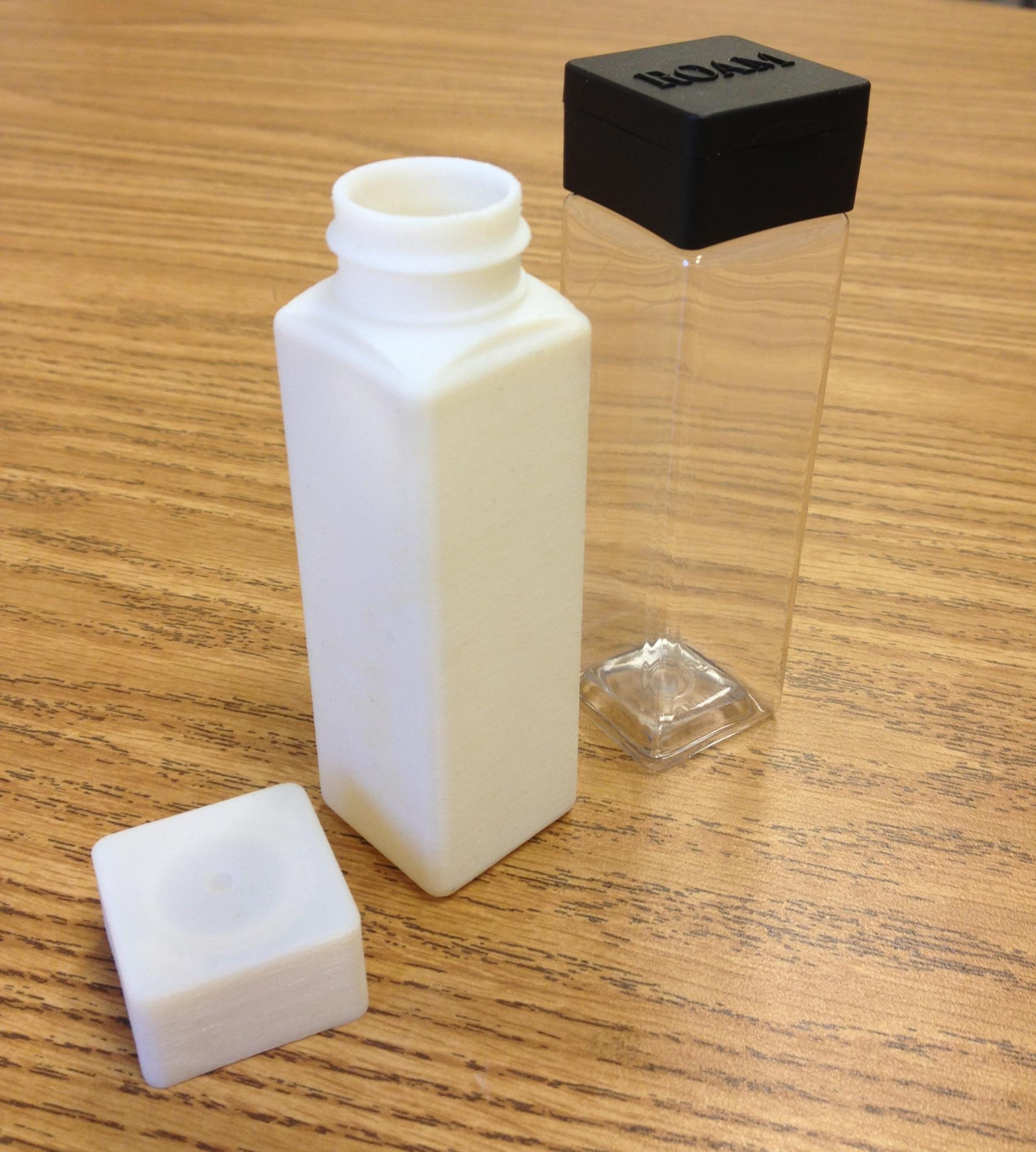

Currier Plastics was an early adopter of 3D printing. After doing a study on the cost to have projects done at a 3D service bureau versus having that capability in house, Currier added an Objet 30 model printer a few years ago. The 3D printer acts as a "tool" in proving out design concepts, fit and function and even aesthetic appearance, Gary Kieffer, VP of new product development, told PlasticsToday. During this time, Currier has printed approximately 425 bottles, jars, canisters, closures and lids, and continues to find new uses for the technology.

While Currier has printed many type of bottles, jars, canisters and components such as brackets and fixtures, every concept has its own challenge when it comes to 3D printing. "For instance we have to increase the wall thickness of a 3D printed part," said Kieffer. "Another feature of the 3D printer is the support material that is required when printing or building models. We found that when we printed bottles with small neck finishes we were experiencing longer clean-up times due to the time to do secondary support. We ultimately had to build the bottles and based separately and glue them together after the material clean-up was done. This cut clean-up time by 75%."
