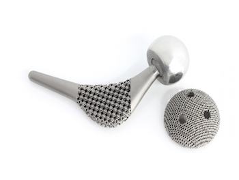

"Many metal 3D-printed parts are no longer used as prototypes but as complex, low-volume manufactured components," explained Gordon Styles, president of Star Prototype."As a result, many of these parts need certain high-precision features that are virtually impossible to produce with 3D printing alone. Problems arise because most 3D-printing companies don't carry out secondary machining, meaning customers need to take care of the finishing work themselves or farm it out to a separate specialist machining bureau."
With the AddSub process, Star Prototype uses its Renishaw AM250 3D printer to produce components in titanium, stainless steel or aluminum. The resulting parts are then finish-machined on a recently acquired Haas five-axis system programmed with PowerMILL. Star Prototype sees the combination as being ideal for the production of mating faces, precision bores, tapped holes, spigots and other high-precision features. Whenever possible, the parts are built on the AM250 in the correct orientation, with machining supports designed so the build plate can be transferred directly to the five-axis machine.
