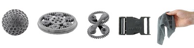

Large printing widths achievable with HSS print heads make the process even more productive compared to other additive manufacturing processes. |
Versatile and fully functional prototypes such as brackets, housings and other functional parts for end use can be produced. |
The basis for HSS is the same as voxeljet’s core technology, called binder jetting. HSS works by selectively jetting an infrared absorbing ink onto layers of plastic powder. Each layer is exposed to infrared light, which melts the powder to form functional plastic parts directly out of the machine.
In addition to voxeljet’s present tooling solutions portfolio, the new HSS process enables printing of parts with properties and qualities similar to selective laser sintering, multi jet fusion or injection molding according to the company. Versatile and fully functional prototypes such as brackets, housings and other functional parts for end use can be produced. In combination with excellent surface quality, sharp and clear edges, as well as true-to-detail resolution, HSS parts can be directly used for functional applications in automotive, industrial equipment, and even consumer goods according to voxeljet.
