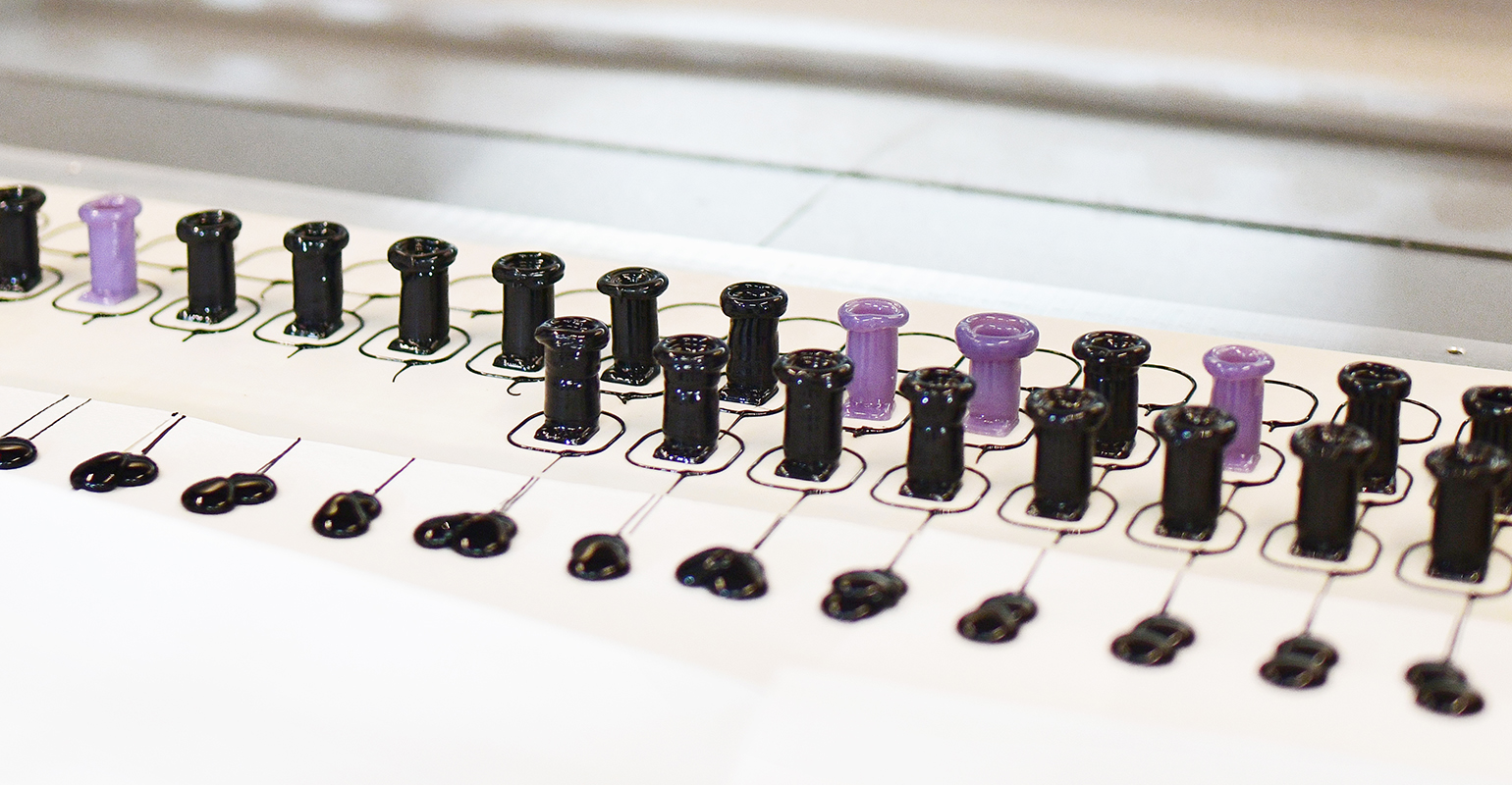

3D-printed grommets
Grommets and other high-quality polyurethane parts can now be 3D printed without post-processing requirements or surface finishing.Image courtesy of Chromatic 3D Materials
Smooth-Mode technology, developed by Chromatic 3D Materials, enables 3D printing of durable rubber parts with ultra-smooth surfaces at commercial volumes. High-quality polyurethane parts, such as seals, gaskets, grommets, and bladders, can now be 3D printed without post-processing requirements or surface finishing, said the company.
Sealing requires a smooth surface, but 3D-printed parts typically have layer lines or roughness. “We have developed a way to easily and cost-effectively 3D print products that are ultra-smooth without additional steps,” said Dr. Cora Leibig, Chromatic CEO and founder. “It’s a breakthrough for 3D printing those professional applications that must be air- and water-tight.”
Parts printed with Smooth-Mode technology have superior aesthetics as well as finer dimensional accuracy, claims the company. For example, products can be printed with precise uniform thickness at sub-millimeter scale, enabling the printing of elastomeric products that expand and contract.
To achieve this outcome, Chromatic’s team of additive manufacturing experts began by fine-tuning the viscosity and surface tension of the company’s printable thermoset polyurethane materials. “We developed a way to go beyond simply applying our reaction technology to fused deposition modeling (FDM). Smooth-Mode uses chemistry to create an ultra-bonded and smooth part. We believe this printing technique delivers the world’s smoothest printing along the Z, or height, axis,” explained Dr. Bart Engendahl, Chromatic’s managing director in Germany, where the company was founded in 2016. Its US headquarters is in Golden Valley, MN, a suburb of Minneapolis.
