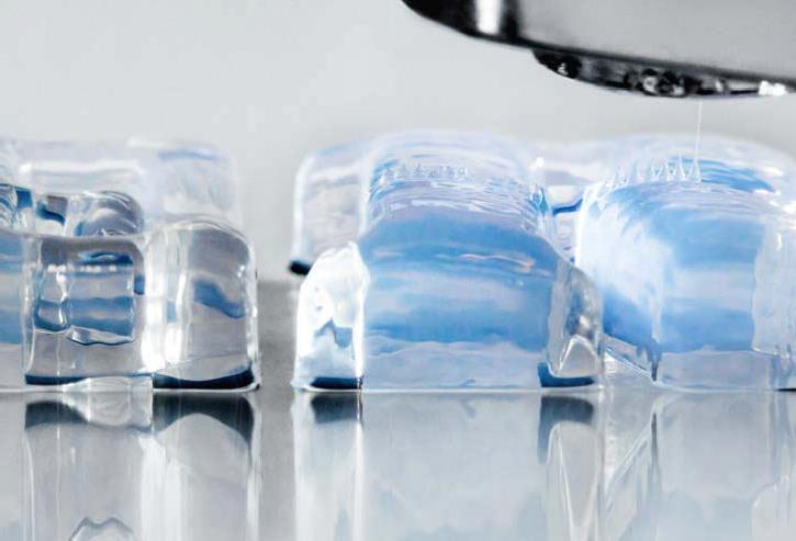

The new 3D process silicone process operates with extreme precision. The printer robot produces structures with a line width of 0.6 millimeters. The silicone is placed drop by drop, and is immediately firm after application. This enables extremely precise contours to be produced. (Photo: Wacker Chemie AG)

Silicone is not melted by heat in the same way as thermoplastics or metals. It cannot simply be applied layer by layer as a powder, and melted by laser beam to the desired three-dimensional shape. The experts eventually opted for a process that they developed in just one year. The result is impressive. It all takes place in a glass case containing the workspace and a robot. The machine is equipped with a nozzle, which rapidly deposits one droplet of silicone at a time on a base surface. Not just anywhere, but at exactly the point governed by the computer file with the design software - just like inkjet printing on paper.
The developers couldn't use an off-the-shelf solution to control the robot. "A key step in the development work was to write a custom program," says Florian Ganz, CEO of enders. Pachaly reckons the work truly paid off: "It is the first really user-friendly software in this field."
The robot regularly pauses and a UV beam scans over the tiny drops, which have merged into a fine line. The silicone then vulcanizes in less than a second in the UV light, crosslinking the molecules into an elastomeric material. The robot then applies the next layer of silicone droplets. Thanks to the vulcanization, a homogeneous object is formed because, after being applied, the viscous material immediately bonds to the layers immediately adjacent to or below it. Currently, a relatively small component can be formed in around 15 minutes. In the long term, the developers want to process about 100 grams of silicone per hour - which would apparently be fast enough for any conceivable application.
Since the structures generated by the robot are extremely fine, the precision is impressive. The silicone strip deposited is about 0.6 millimeters wide, and only half as thick. That makes it possible to produce extremely precise contours and results in a surface that is almost smooth and is pleasant to the touch. "The roughness may be even better than 100 micrometers," says Pachaly. That is hardly a hair's breadth, and significantly smoother than printed thermoplastics.
The pieces look almost like injection molded components. To achieve this, Dr. Ernst Selbertinger, a silicone developer, had to create a formulation that can be dosed as tiny liquid droplets that immediately remain stationary at the place they were deposited. "Think of toothpaste - it flows under pressure as you squeeze it from the tube, but it is firm when on the brush," explains the chemist who won't disclose any details about the mixture - only that it contains a platinum catalyst that is responsible for crosslinking the molecules under UV light.
