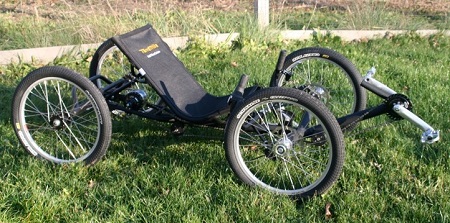

Beta customer Utah Trikes is using the carbon fiber-reinforced polyamide grade from Stratasys to fabricate customized components for its recumbent cycles.
FDM Nylon 12CF beta customer Utah Trikes is taking advantage of the material’s properties throughout its development and production process to make significant cuts to its product development times. The company is a manufacturer of tadpole recumbent tricycles.
“The excellent strength and stiffness-to-weight ratio of the FDM Nylon 12CF material is a game changer for us. It means we can prototype almost every part of our product on Stratasys FDM 3D Printers in under two weeks, where in the past it could take us over two months,” said Ashley Guy, president and CEO of Utah Trikes.
“I no longer have to constrain my designs because of prototyping limitations. Now I can focus on designing better, more functional parts without worrying about how to shape the aluminum or how to lay up carbon fiber onto the molds. Stratasys FDM Nylon 12CF parts can be 3D printed faster, with superior stiffness-to-weight performance and with better repeatability than any other 3D printing technology or vendor we’ve seen,” continued Guy.
