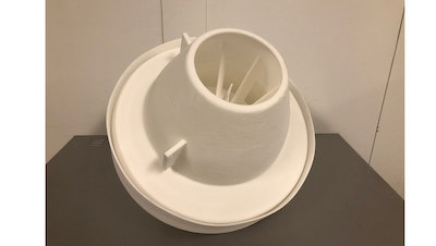

Volvo Trucks used 3D printing technology to develop a one-piece diffuser used in the paint atomizer cleaning process, saving the company more than $1,000 per part, as well as eliminating the need for a multiple piece component.

Volvo Trucks used 3D printing technology to develop a one-piece diffuser used in the paint atomizer cleaning process, saving the company more than $1,000 per part, as well as eliminating the need for a multiple piece component. Spare parts were also produced for the 20 that were created so that they can easily and quickly be replaced should wear occur.
