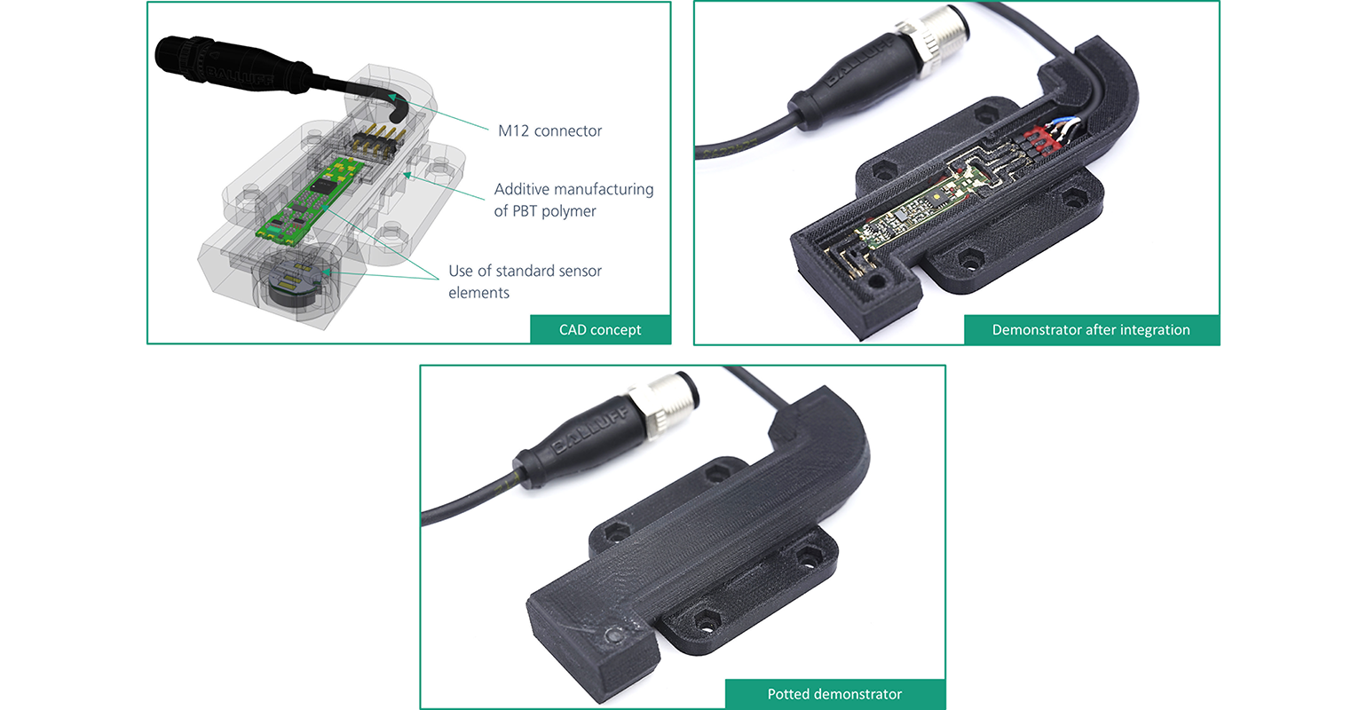

inductive sensor schematic
Image: Fraunhofer IPA

Compared with other additive manufacturing platforms, the freeformer’s open system technology is compatible with a range of materials, including production plastics. PBT granules were fed into the freeformer, which uses a material preparation unit with a special plasticizing screw. In the mold-free process, tiny plastic droplets are precisely positioned including cavities for the electronic components, layer by layer, with the aid of a movable part carrier. The freeformer automatically pauses the process at each layer to integrate the coil, circuit board, and plug. In a separate process, a dispenser lays down silver conductor tracks inside the housing. To complete the process, the cavities are overprinted and potted in polyurethane, explained Fraunhofer IPA.
More than 30 demo models of the custom sensors were produced. Tests showed that the PBT-based sensor could withstand temperature changes and vibrations, is waterproof, and provided adequate electrical insulation, said Fraunhofer IPA.
