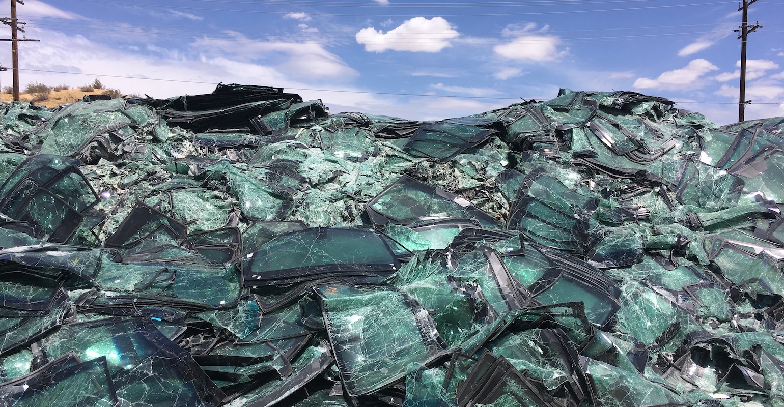

Laminated glass from vehicles often ends up in landfills. To address this issue, Shark Solutions, a Danish clean technology company, recycles automotive windshields and architectural glass to extract PVB, a thermoplastic used as an interlayer in the laminated glass panels. Developed through a collaboration with Shark Solutions, Avient’s proprietary formulations incorporate PVB in combination with other recycled raw materials. These new additions to the reSound REC TPE portfolio are comprised of 60 percent recycled content, while delivering performance attributes comparable to those of traditional products – including aesthetics, haptics and physical properties.
