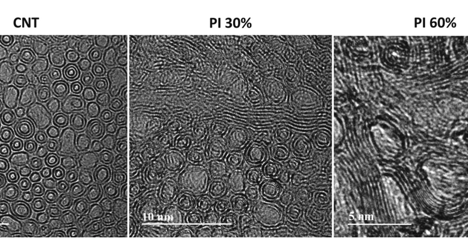

carbon nanotubes with polyimide concentrations seen under microscope
Image Courtesy of Korea Institute of Science and Technology

Additionally, microstructure analysis verified that the physical properties of the fabricated material were improved by reducing the voids within the fibers, and that the CNT/PI combination improved the orientation of the carbon nanotubes. The research team was able to fabricate these high-strength fibers with improved modulus while replacing up to 50% of expensive CNT with PI to lower the overall cost.
