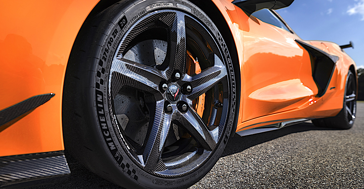

A Carbon Revolution wheel on a 2023 Chevrolet Corvette Z06.Image courtesy of General Motors Co.
A highlight of the 2023 Chevrolet Corvette Z06 is the availability of lightweight carbon fiber wheels from Carbon Revolution, as we’ve seen previously on cars like the Ford Mustang GT350 and GT500 and the Ferrari’s 8 highest performing models.
These wheels save 41 lbs. of weight from the car, which is a lot for any component. Because this weight is eliminated from the car’s unsprung mass and from its rotational inertia, the effect is transformative.
