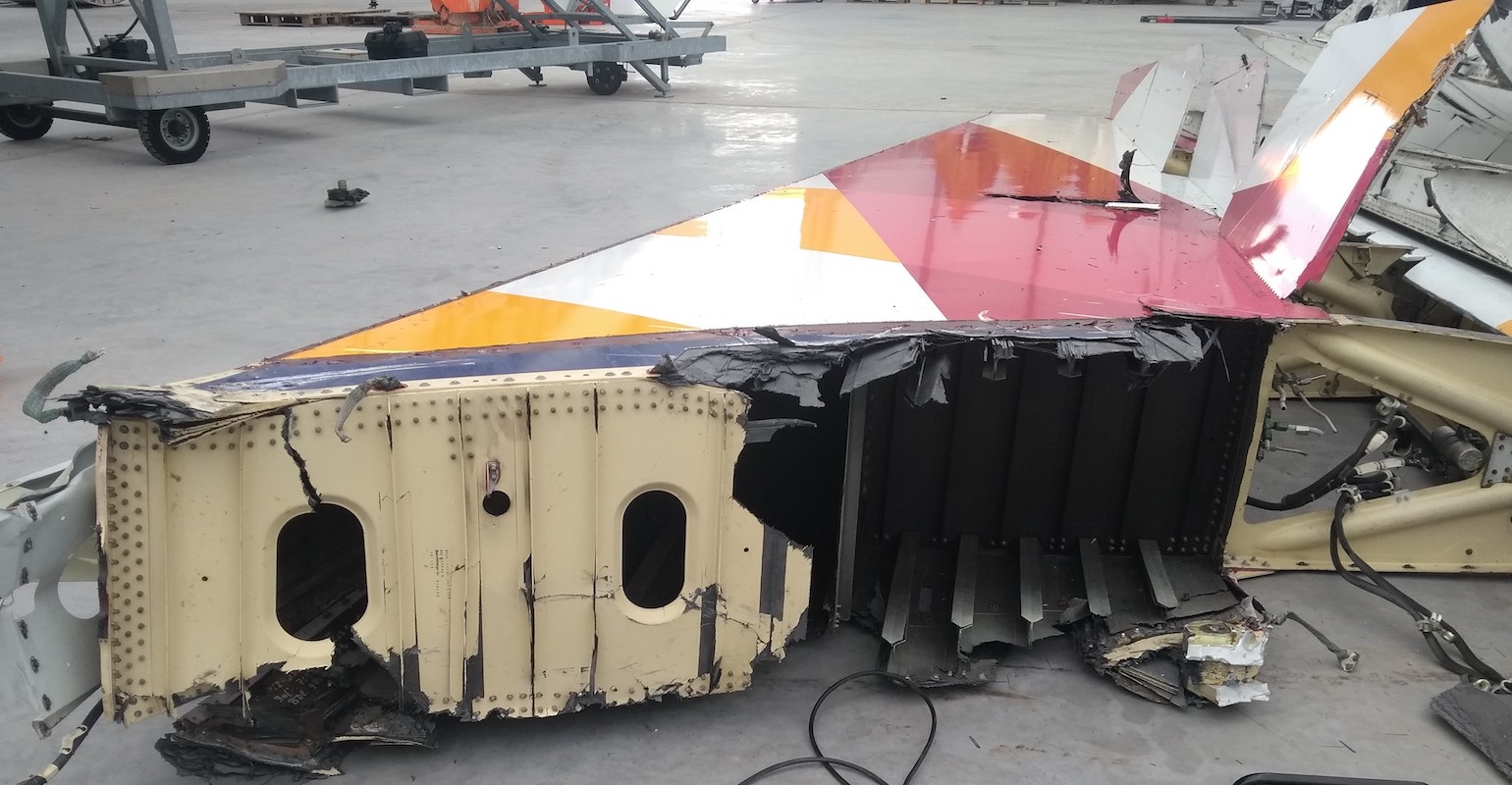

Project targets recycling of carbon fiber from end-of-life aircraft. Image courtesy Aerocircular. |
