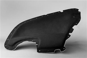

Thermoplastic honeycomb core production technology provider EconCore (Leuven, Belgium) will showcase applications developed by the first North American licensee of its ThermHex technology at NPE2018. Several interior automotive parts from Mexico City–based Fynotej will debut at the EconCore booth, S31192.
Fynotej went into production earlier this year with a range of honeycomb sandwiches for automotive interiors. The PP honeycomb boards, branded Fynocore, have a PP honeycomb core with thermally bonded, in-line skins. The boards are available either as solid PP sheets or with a non-woven surface finish, combining low weight with high performance and aesthetic appeal.
