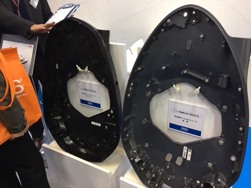

Marine outboard motor from Yamaha now incorporates a glass fiber-reinforced polyamide component that saves around 7.7 kg in weight.

In a real world application of the grade, Yamaha Motor has adopted grade JF-30G for the bottom cowl top of an outboard motor, thereby slashing part weight from around 12.3 kg in for the previous aluminum die-cast component to just 4.6 kg for the glass fiber reinforced PA grade.
